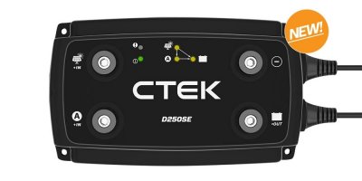

A little question about my CTEK D250 SE. Is it necessary to connect the red/black cable to the negative pole of my CTEK if I use a GEL battery (not AGM). I have a little problem cause there is only the "A" lighted and the Alternator seems not give energy to the leisure battery. The green light is not lighted (before I had the three lights : the green, the A and the battery light. The CTEK can't charge my GEL battery like before. Thank you for your help.

The problem does not seem to be solved. But something new I have now a Green light flashing on my ctek d250se next I shut down my t6 (with smart alternator). All the cables are connected like they said in the manual.
Where have you connected the thin red cable?
The manual says you are in current saving mode, maybe your leisure battery is fullAF774A09-0556-4B85-ABD9-A777295A8734.png
Take that fuse out and check there is a current there which comes on when you turn on the ignition. I have just checked mine, green flashing light with ignition off, solid green light and two flashing amber lights with ignition on (engine off) solid amber with engine running
