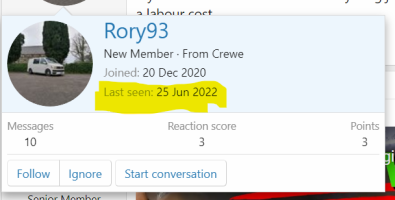

@phantom-uk
It may be a while before @Rory93 replies, he hasn't been on here for a while...
If you tap on his forum name, the above info is shown
