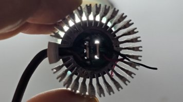

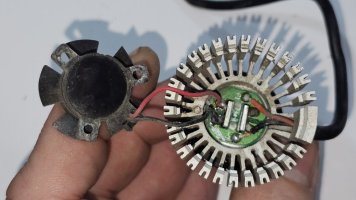

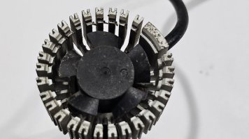

Example of my old fog LED bulbs.
The air gaps between the "inside" and the "outside" can be seen below.

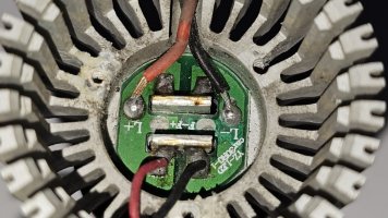

My solution (or improvement) to the problem is reversing the polarity of the supply to the fan.
In some cases desoldering & swap over of 2 wires is required(fan blades don't work in the most efficient way, but still work), in some other cases there is a possibility to physically rotate the fan and reverse the air flow.
By changing the direction of the air flow the air is constantly sucked out of the fog lamp, so is any condensation.
