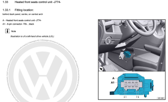

It's behind the panels at the root of gear selector column.
Hmm, the illustration is for LHD... on LHD you can't reach it via fuse box, probably someone here knows about RHD?
At least on LHD not very difficult but still requires torx bits, trim tools, and some patience. It's not just opening a hatch that's meant to be opened by customers and sticking in a replacement. If tearing panels off is not your thing I would let VW or some other shop to do the job.

thanks for the replies. I did think it was underneath the centre part of the dash and lower down but mine is auto and has a bottle storage compartment there.
Yeah the whole lower dash, including glove box and the panel up to the light switch has to come off unless the module can be reached through the fuse box opening in RHD. DSG / manual or standard / comfort dash does not matter.
