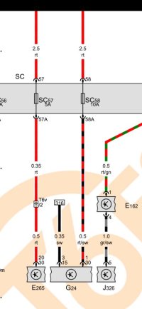

I do hope you can help, the rear controller for blowers has stoped working , I've popped the unit out and tested the red and brown wire. Witch I would assume is L and neutral and I get zero voltage. Is there a fuse for this unit please..
OK.. sorry to add another post, doing a little digging.. love the VIP perks here.

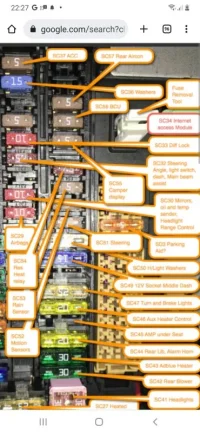

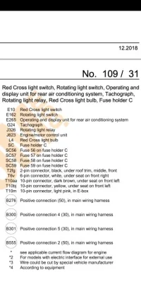

I am on the right lines that the fuse SC57 Is direct to to rear control panel.. via a 6 pin connector under the front right seat. T6V. What is the /2 ie T6v/2
/2 is the pin number. So T6v/2 would mean 6 pin connector pin 2, location of the connector is usually in the right hand column, look for T6v from there
Thanks for the reply, pulled the fuse, and it was blown. Inserted another and that blew straight away. Sc57.
