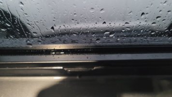

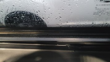

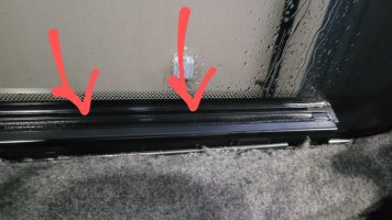

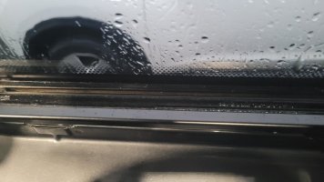

Hi everyone, I have noticed that the internal channel which my "Camperglass" sliding windows slide along, to open and close is wet when after the last few days of rain.
Having only just had them fitted, as I had original OEMs before, I am not sure if this is the norm.
I've posted some pics for you to see, in the hope that this is meant to be the way they drain, as I have seen no puddles of water on the floor or dripping down the internal panels.
TIA

I messaged Camperglass today and had the reply that it was normal and is the process for draining. Odd though, that it happens inside the van.
As a side note, I also said that they were difficult to slide open and closed and was recommended to use silicone spray to help things.
Check the drain channels haven't got any adhesive stuck in the channel. I had a problem where mine was leaking into the van. I had been careless with bonding adhesive which partially blocked the channel. After using a sharp probe I managed to get most of the extra adhesive out of the channel and now it stays dry(ish)

Assuming this post is about the flush camperglass sliding windows.... mine have been fine. Been in some heavy rain. You do get water in the channel mentioned above. But that is the drain channel. If the drain is not blocked, you can pour water in the channel and watch it drain out the drain hole on the exterior of the van.
The only downside is if there's a bit of water in the drain channel, and you quickly close the window, some water can splash out the forward end as it shuts. No biggy though. Great windows with improved design. Would buy again.
