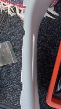

B08F802B-DD99-4077-A35D-FF64F8A83160.jpeg0CA79BB7-981C-446F-A75B-ACD6535156CA.jpegAFE86ED1-647C-4CE8-BBD7-49BB70B29AF8.jpeg43807319-F95B-4C88-A96F-468EBC267170.jpeg84B3045A-324A-4F99-819B-9D41C9034286.jpegToday I set to and fitted a genuine B pillar grab handle (£68 from EBay) to my Transporter. I kept the bracket as it came, but covered it in 4-way stretch carpet. I used a multi-tool to modify the upper b pillar trim. The grab handle locating spigots were trimmed back and it’s attachment bolts cut short. It all bolted together quite well - see pics
View attachment 109010View attachment 109006View attachment 109008View attachment 109009View attachment 109007Today I set to and fitted a genuine B pillar grab handle (£68 from EBay) to my Transporter. I kept the bracket as it came, but covered it in 4-way stretch carpet. I used a multi-tool to modify the upper b pillar trim. The grab handle locating spigots were trimmed back and it’s attachment bolts cut short. It all bolted together quite well - see pics
Hi Keeffe. Is this a T6 which has had the bulkhead removed? You have covered the bracket in stretch carpet but could it just be sprayed or would that look a bit messy?
Neat job by the way!
@Tiggy1955 Yes you could just paint it, there are some threads showing it painted. But it sticks out a bit, so I thought I’d hide that with some carpet. I have a T6 Transporter camper conversion. It came from factory without the bulkhead.
