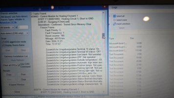

They stopped working so scanned the van and it's coming back with 2 faults on the heated seat control module. It's says both circuits are short to ground.
I've unplugged the seats and stripped back the wiring so it's just the oem wire with nothing plugged in and I'm still getting a fault.

Can you post a screenshot of the faults? If the seats are not connected they will throw a fault. Did you check the fuse for them? Yours is t6 or t6.1? The module in t6.1 is clipped on the left centre dash support leg behind the gearstick trim by the floor so pita to access
Yeah I'll get a screenshot this evening.

Thats some weird looking faults that make no sense to be honest. The main module still only feeds the temp sensors and both heating pads per seat at same time not independently. Can you check if you have any voltage on the temp sensor wire grey/purple and white/blue on other seat when seats are on at any setting 1 2 or 3?
The sensor wire is saying between 9-10v. When I first did the seats, they were reading about 2.5v
Not got a clue what's going on with it!
