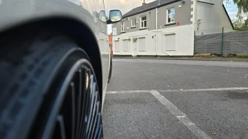

I’ve not fitted them yet. Picture is how it looks now on 18’s. Just wondering what size tyres. New rims are all 10j not staggered. I’m thinking 255 on the front maximum. Just wanted to avoid rubbing.You fitted 10x20 on the front or rear ?? Definitely quite low
Thanks for the advice and pictures. I think mine are et38 though not 42.These were 255.35.20 et42 and i had zero rubbing at ride height and aired out with no issues so i wouldn't go any bigger with tyres......you will get quite a good stretch with a bit of rim poke.
