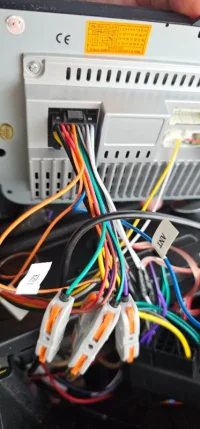

Installed this head unit from SCR, came with no wiring diagram. Unable to identify reverse camera signal feed. Searched around but nothing. No setting on the unit (it's pretty locked down) to check. All I have are the numbers. Any help appreciated, thanks, Rik.

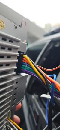

It’s always the 3rd from the power feed in every loom. Usually pink or brown.

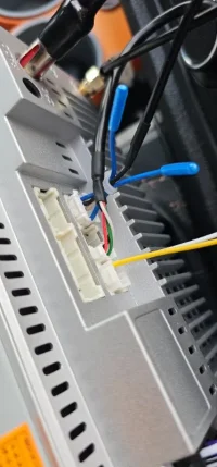

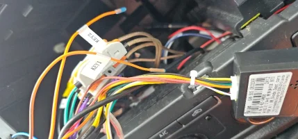

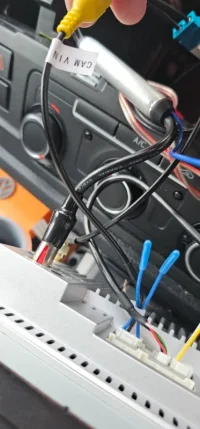

Hi. Ok, finally got time to look. All the cables that are not speakers seem to go from the head unit to the can bus decoder. The only free wires seem to be key 1 and key 2.There are 2 blue cables not connected that are in the same conne tor as the yellow cam cable. Does this help at all? Thanks.
