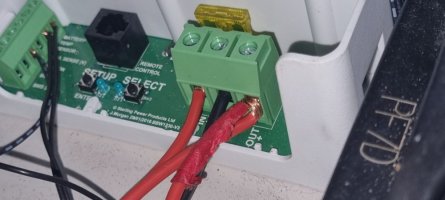

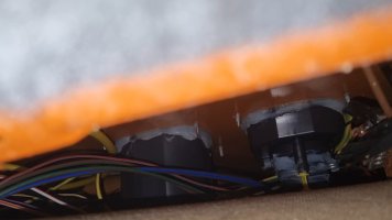

  • Poor wiring in conversion,

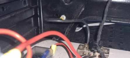

    • Earth cable attached to a wonky screw in drivers seat (only noticed as i got a shock last week whilst disconnecting the leisure battery to change a blown fuse)
    • Loose cables and not properly insulated (can see the copper wire poorly pushed in the the batter charger)
    • Tripped MCB Looked at wires behind the fuse board to find them all just hanging around near bare screws.

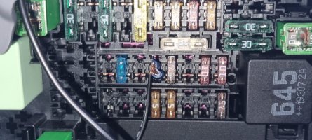

    • this black wire, wedged into fuse box ( again no idea where it even leads too).

    • Rust residue on earth block, held in place with 1 screw.

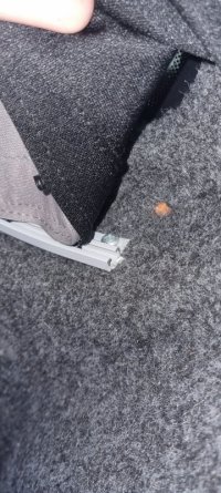

    • Pop-Top has screws missing, noticed on Saturday when popping little boy to bed. with the fear of him being crushed i closed it.

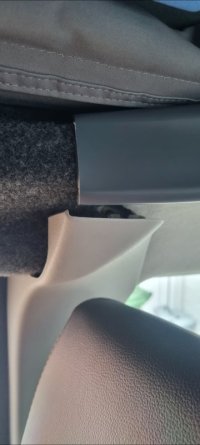

    • Carpet on roof not stuck properly
    • Missing plastic screw grommets, to access behind. (assuming more wires?)
    • When checked wires as mentioned above, looks as though there is no insulation.
    • Double Swivel Passenger Seat doesn't appear to secure into the actual vehicle, its just goes in the the lino.

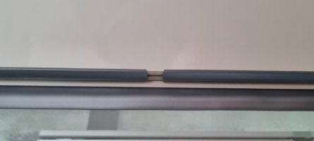

    • PVC finish around units is too small gaps of over 1cm to join.

If that were the case I’m fairly sure the seat and passenger would have moved at the first sharp corner.

The electrical work definitely wasn’t carried out by an auto electrician with a conscience or any self respect.
