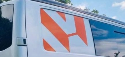

The passenger side would be OK. We can make a new ply panel with a window at out. This will then replace the panel that's already there.
We would most probably just have to carpet around the new window edge as we wrap this round the cut.
I've added a picture of one done and also showing how we fold over the carpet externally.
The drivers side doesn't look as straightforward to add a proper window and I would want to see it before I said anymore, but adding a dummy window would be fine.
