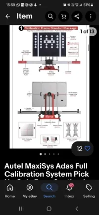

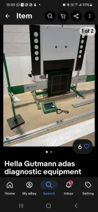

Are you on standard wheels and suspension?
Is the ride hight changed from factory?
You can look at having it re. Calibrated.
Some garages and MOT places can recalibrate....it needs a specialist machine, a bit like a Hunter wheel alignment machine, but added the ADAS stuff.

View attachment 229958View attachment 229959
