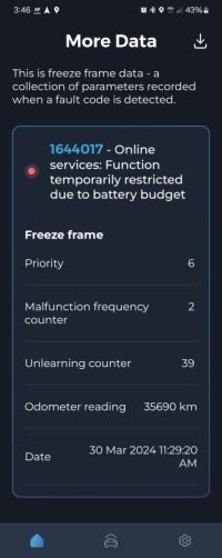

Got this Telematics error the other day. Cleared it first with Carista and then with VCDS, but it keeps coming back. On the dash.
Vehicle says everything is fine and there are no warning lights, but there's a periodic chime that's low and pings 3x.
Traveling in South America. Any specific instructions would be appreciated.1000062712.jpg1000062715.jpg1000062726.jpg1000063258.jpg
Most telematics modules have a built in backup battery.
In your case the module itself reports a fault, claiming that this battery has a 0 mAh capacity left.
Typically these batteries are 7.3V and capacity of 1390mAh.
I would try to replace it.
The telematics boxes have been slightly problematic on the T6.1 with lots of examples of units showing errors, i think earlier vans got a software update but have heard of quite a few getting replacement modules but never seen one myself so not sure what error codes are typical for these in comparison to what you have ?

Thanks. Any idea where the battery is? I'm in Argentina and they don't sell these vehicles here.
My Google searches on my phone have also been fruitless, so any other hints/specifics would be greatly appreciated.

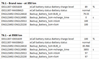

On T6.1 the battery status is available via VCDS advanced measurement values - below snippets from two different vans.
Per wiring diagram the unit 75-Telematics (J949) connects to KL30a wiring harness - thus permanent 12V there.

I have just been and looked at the status of mine in the TGE after yesterday's journey. All good now!
Address 75: Telematics (5WA 035 284 G)
12:53:04
IDE11307-IDE01839 eCall battery status-Battery charge level
99%​
IDE11307-MAS08415 eCall battery status-Battery statusnormal
ENG254564-ENG255490 Backup_Battery_SoH-BUB_ci
85.738​
ENG254564-ENG256057 Backup_Battery_SoH-mcharge_time
3625​
S
ENG254564-ENG256085 Backup_Battery_SoH-mSoH
93​
ENG254564-ENG256302 Backup_Battery_SoH-rSoH
94​
