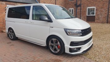

340mm AM 4 pots fitted
Can I ask where you got these from ? I want to get some big brakes for My T6 but its all a bit of a nightmare as don't know what to fit !
I got the calipers second hand from ebay. Vagbremtechnic brackets and use original 340mm discs.
I would have gone porsche 6pots but these fit under the sportline wheel (with a 10mm spacer).
However this ended up a lot cheaper!
I got an Audi S4 6 pot Brembo kit but they wont fit without a small spacer and my new wheels are 10j wide so tbh i'm not sure what to do with them.
Is it worth changing to a different wheel?
What discs are you using?
The wheels are brand new and only been on the van as a test fit. Using 340mm discs...........maybe if i got the 375mm disc from SF Tuning they would fit without a spacer but that's another £264 trial and i would need to move the caliper back. All turning into a headache lol !!!
I still need a spacer made up to align the callipers with the disc so another option is to get that done and sell it as a full kit.
