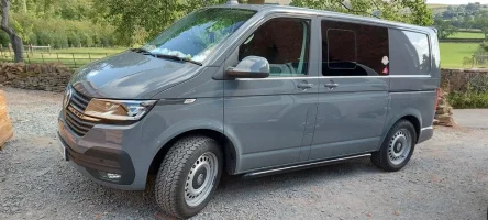

Evening bud, I run amaroks and 255/60 will fit in the arch but will rub and even worse cause damage to the bodywork when on lock and suspension compressed.
Biggest you can run without issues are 235/60 20200912_154314.webp
