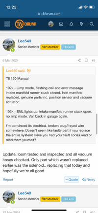

good afternoon
I've got a 2016 t6. 115,000 miles drives ok, but like most at that mileage the coil light flashes and goes into limp mode. it has been doing this for about 4 weeks on and off
but the last week it would not clear. so trip to TPS and £350 later i have a brand new bit of plastic. 3 hours later fitted and running, cant believe how bad the build up was inside the inlet and the head.
my problem is the fault does not clear with the new inlet on.
no vac leaks
tested the new inlet
but the mad thing is about this problem if i leave the vac pipe off the inlet the van drivers fine, not fault no lack of power.
has any seen this before please
