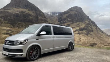

Gary - we have 20s on our t6.1 with Crs Koni 40mm drop. Given the chance I would have definitely put on 17” swamper as we live on the west coast of Scotland. It does drive really well but always worried about the wheels…personal preference ok but I’d think twice given your use! IMG_2602.jpeg
Gary - we have 20s on our t6.1 with Crs Koni 40mm drop. Given the chance I would have definitely put on 17” swamper as we live on the west coast of Scotland. It does drive really well but always worried about the wheels…personal preference ok but I’d think twice given your use! View attachment 233255
Looks really nice
I think you’re telling me what I really know deep down but really wanted the look. I think we would be paranoid given the side ditches, potholes etc. Maybe 18’s would be the real compromise
