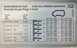

FWIW this is the sticker VW put on the door pillar of my T5.1 (t28 highline)…IMG_1303.jpeg
I keep coming back to it trying to decide what wheels to go for when my tyres need replacing. I want comfort above all else (and my 215/65 16 don’t give me that) and I keep reading posts on this forum and others that lower PSI means better ride. With that in mind I’m really tempted to change my 16” VW alloys for a wider 16” with the 235 wide 104 load rated tyres as this has low pressure and a decent load rating.
However you can see for 18’s (on my van at least) 255/45 on 8j rims would be VWs choice and these are the next lowest pressure on the chart so, based on the feedback/comments of many, would be more comfortable.

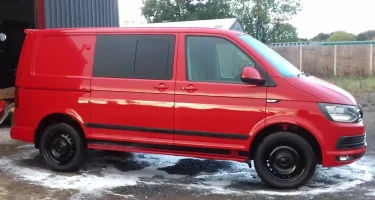

Any pics of your 235 55 r18 on the van pls and is your van lowered ???

Yes I ve worked that one out already . I have had my suspension done at CRS performance and it's vastly improved . Just wondered what the 55 wall would look like
