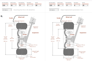

I would like to put some 17 x 8 5/120 35 offset wheels with 225x 65 17 tires on a standard LWB T6.1 tdi340 van
These wheels are supplied by a kombi upgrade supplier in Australia they say they will fit but I’ve also inquired at 3 different large tyre retailers and they all have said these would not fit or would not comply
Has anyone fitted similar size wheels and tyres on a standard T6.1 van?
By my calculations they "should" be OK.
In terms of compliance her in NZ diameter is not allowed to be more than 5% of OEM size, with OEM for 17 inch wheels is 235/55x17.
It looks like the 225/65x 17 will just squeak in to that compliance.
