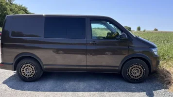

So looking to change my springs due to corrosion. Currently sat on -40 springs.
What's my best option as I am running 235/55 R18 All Terrain Tyres.T6 LWB 4MOTION
-40 again or back to VW standard? I can't find anything in between and the side bars slightly rub the ground when pulling onto my drive. If I stay -40 will probably remove the bars.
Could do just springs or full kit.
Thanks

Hi. Thanks for the reply. Yes, currently dropped by 40mm so would not want anymore than this. Ideally something in the middle at 20mm but that does not seem to be a thing unless I go air.
This is mainly a leisure vehicle and will spend a lot of time at events going in and out of boggy farm fields which are often filled with stuck vans. The ride quality is a lot better than I expected and as not doing huge miles was a compromise I was willing to take to not get stuck.

Thanks. Measures at about 400mm.

Thanks. Measures at about 400mm. Currently just a Kombi. Pop top going on next month.

So IIRC and/or assuming @The Bear78 has the standard ride height correct at 460mm, you are already at -60mm (not -40mm) with as you note a currently unconverted van (ie before you add weight!) - although noting that a LWB 4Mo is already a wee bit heavy (I have the same myself!!). As I suspected!
Get yourself to @CRS Performance and get yourself some springs that can actually carry your weight!

Thanks all. Think I am going back to standard height.
Anyone got pics of their van at standard height on 235/55 R18’s?
