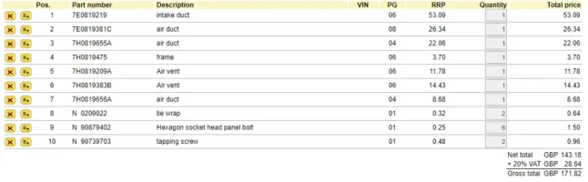

I can indeed, have done this before for another member, input/output pipe connections/vented step/b pillar/vents etc
sorry mate forgot about this, pic below show the duct parts and price list (ignore part 7 on the price list as it shouldnt be there as its part of the rear heating)
In addition to this you will need the main B pillar trim which is around £61 + vat and a vented step which is £46 + vat but i do need to confirm i can get the step without the oval caravelle style light cutout
As a vip you will get 5% of all these prices

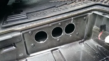

A. Part 1 show does screw to the back(external) side of the drivers step. The metal panel of the step wall is not cut nor has a blanking plate, therefore will require cutting.. now from my understanding this can simply be a minimum of a 60mm hole (See image attached). Or you could do it properly and shape to suit a vented side step.

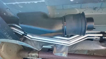

Image 1 - part 2 housed into underside of kombi b pillar
Image 2 - 60mm recirculation vent holes(not done by me!)

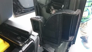

Image 3 - Internal b pillar(minus trim) with outward heat vents to front/rear.
