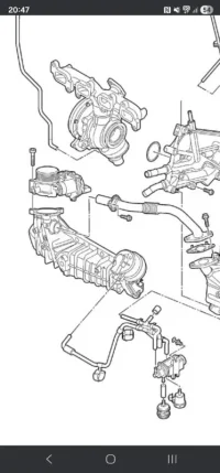

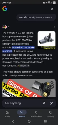

I have vw t6 cxfa engine dsg
I have had a few problems with eml on
Different codes. Had loss of power. P2279 Air intake leak detected, and p13d6 cylinder 3 inplausible pressure signal.
I did smoke test. No leaks present.
So changed air flow meter. Genuine
the glow plug was changed 7 months ago along with the other 3. Genuine parts it felt better. But not 100% but didn't give me any codes. Untill I done long distance approx 100 miles. P0299 turbo underboost.
I have also checked both the egr pipes front and back. Rear one was changed last year. No leaks here either re tested with smoke machine. No visable leaks.
Is there any thing I am missing.
Or is it just a faulty turbo.
