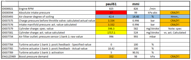

Thanks! Intriguing... indeed sensor for "Absolute intake pressure" reports abnormal value for idling engine, and even for stopped engine
We were a bit lucky - I had in my files a data capture from the same engine, even with the same engine software.
Basically just confirms what was already captured in the freeze frame data - intake pressure reported 37 kPa - which seems to be totally out of normal operating envelope.
Below a few other data points - it looks like engine is trying to compensate that by applying full boost even on tick-over.
Have you checked air filter and airways into engine? See the "Air cleaner degree of soiling" above. However, what I have noticed the value just seems to wander around so probably not relevant.
I would concentrate why channel IDE00594 reports the value - even engine stopped (in your other recording) when it definitely should report the same as ambient air pressure, approx. 100 kPa. A wiring problem? Does it ever report any other value?

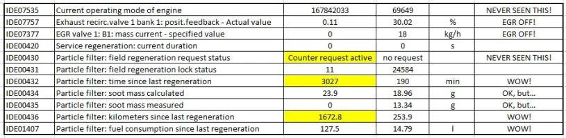

Besides the above the engine seems to have ignoring DPF regenereation requests - however this is probably just a consequence of the main fault.
