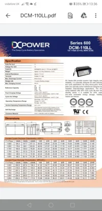

I can get 110ah AGM which will fit under the seat, will this be compatible with my 30a charger being an AGM battery and able to take high charge currents?Yeah, the Orion is suitable for Lead Acid but at 30A, I would have said it was aimed at the 200Ah+ level of battery capacity.
You may be able to get a sealed AGM under the seat if you can get one that is able to be mounted on its side, Lithium is the way to go, despite the initial expense, the capabilities and lifespan are so much better that the old lead offerings.
Thanks for the advice, sounds like I need the 18a version instead for my setup, although I don't think this comes in non isolated version.
