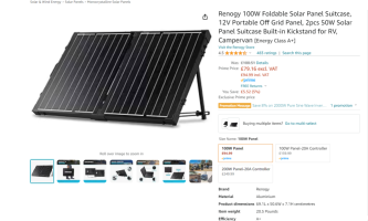

That will enable you to add a second 100 watt mobile panel if you wished.

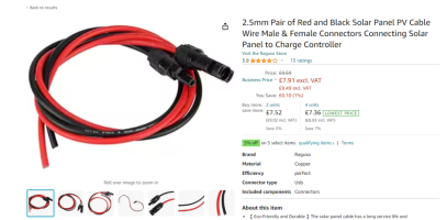

Excellent , will do. Ref the mobile panel how would that “connect” into the system please?
Victron 75/15 ordered . Advice appreciated :thumbsup:
That’s the mppt I have ordered from Amazon.
I assume (?) the tails linked above get hardwired into the same Panel terminals on the controller that the existing panel does currently?
Thanks this is great information, might give this a go for some extra power top up and less battery anxiety if not on EHU . Cheers
