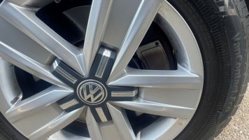

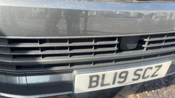

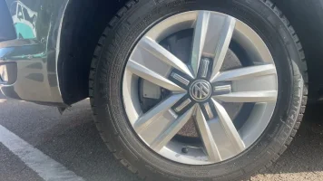

Unfortunately I don't have the part numbers, only the registrations of T6's that have the 340mm calipers / disc combo fitted as standard.
If you let the Vw parts dep't know this reg number, they can (will?) give you the bits you need.
Hopefully you have deep pockets, as the cost for new, will be stupidly huge.
Maybe, Mrs @BoroBoy will buy you them for Christmas?
Or this registration number:
