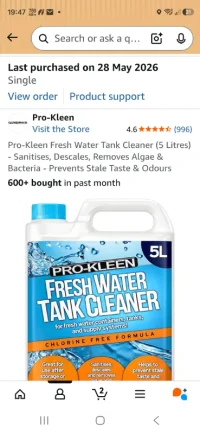

I've just ordered these...
Inline Doesing bottle.
Purclean and Pro Clean stuff.
Screenshot_20260528_194730_Amazon Shopping.webpScreenshot_20260528_194759_Amazon Shopping.webpScreenshot_20260528_194824_Amazon Shopping.webp

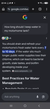

Just done a quick Google:
You should drain and refresh your motorhome's fresh water tank every 7 to 10 days. If the water sits much longer, public water supplies lose their chlorine, which can lead to bacterial growth, stale tastes, and biofilm developing inside your system. [1, 2, 3]
Best Practices for Water Management
  • Regularly Drain: If you aren't traveling weekly, make it a habit to drain the tank completely rather than letting water sit and go stale.
  • Using Additives: If you need to store water for longer periods (multiple weeks), consider using a safe water purification additive like Elsil or Puriclean, or a silver ion water preserver.
  • Traveling Weight: For better fuel economy and handling, try to travel with only 20 to 30 liters of fresh water, and fill the tank fully when you reach your destination.
  • System Maintenance: Perform a deep clean and sterilisation of your water tanks and pipes using an RV-specific steriliser or citric acid at least twice a year—typically at the start and end of the camping season. [1, 2, 3, 4, 5, 6, 7]
I've already drained the tank after a recent Euro trip..... But there is still a small amount sloshing about.
I'll do the purclean thing and leave it in 24hrs,... Then drain. Rinse. Fill. Forthe next trip.?
Maybe leave 10L fresh in there for use after the next trip?
But drain and replace after a week-10days?
