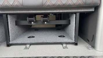

I’ve removed the mounts from my rear panel and it’s now fixed in place with velcro strips. Sounds a bit naff but easy to remove and fit to get better access to under the seat and stays put.
I’ve also panelled out under the seat and used metal button fixings (see pic below) for the front panel so it can be removed but is solid for keeping things in place. These could be used at the rear too if you wanted. I use under the seat for storing bedding at the front and levelling ramps at the rear so nothing particularly heavy.
