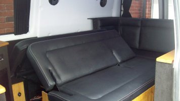

I see how it works in your setup, I guess it could work quite well in the T6.
Its from here Van Furniture even have the pics on there. Real comfy too. Was in the van when we bought it.
Hi Pacswoman, Your van looks great, and that is pretty much the layout I am planning to build. Just wondering where the leisure battery and electrical stuff i.e. consumer unit for EHU etc, are located in this kind of layout?
Leisure battery and trickle charger are under the drivers seat. Consumer unit is in the short bench after the hob/sink unit, which also houses the fresh and waste water, and a gas bottle. Hope that helps.
Liking the idea of u shaped seating for my day van project, seen a few I like Project 77 for one, any one use this layout and have any pictures of the seating being used as I’m not sure it’s going to be big enough as I’ve got a swb. Tia
I used to have the project 77 layout and loved it. I have since sold the van but the link is below so you can see the layout. It’s a two berth though.
