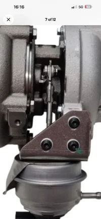

I’ve hunted all over, smoke tested, pressure tested, replaced all seals etc I’ve had a stephacope on the turbo there’s no odd sounds on either side theres no play on the shaft.
When I did the turbo I got rid of the DPF adblue and the EGR it was taken from 102 to 147bhp
Could it be the map?
