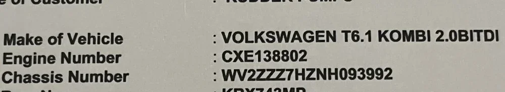

MMI, could you find anything on my engine number?
Oh, apologies not explaining. I had a thought that the issue possibly would have been related with strange (IMO) behaviour of 4Motion described below
However, the strange behaviour - full lock between front and rear axles - even foot off the throttle - has not been an issue with CXEB/CXEC engines. (your engine number CXE....) Also the strange behaviour with vans with DSG happens only on gears 5-7.
Wow, tx for the above.
However my engine is the CXE... and i dont see a correspondence. Or what do i miss?
Mine sounds like traction control activating and only at very slow speeds. Instead of traction control activating, can it be ABS or anything else?
I'm fairly confident the full engine code is either CXEB or CXEC - the last letter (B, C) is just hardware revision. Please find configuration sticker under dash, in driver's footwell - the full engine code is printed there.
