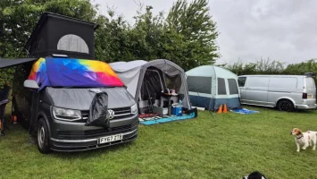

1000041086.webplike this?
I certainly found it easier putting the tent up first. Suppose practice make perfect lining the van up
