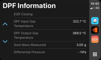

I've been using the DPF app for a while now - not on the van, but on my A6 because it gave me a negative soot measured value and I believed (from further research) that the Pressure Differential Sensor(s - in this case, as it had a pair) were potentially duff.
In the van, I have now noticed that there is NO reading for Differential Pressure.
Would that be an indication that the sensor was knackered, or do these not read them?
I've got a 2016 140 EU5 T6
It maybe something in the app which is not configured correctly, but if it is the Pressure Difference sender, I'd like to know if it's the same as the three I've got in the house
Bloody typical though - no part number

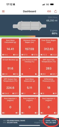

I switched the engine group in the app (it had defaulted to group 5) and I have a differential pressure now, which seems to go from 20 to over 100. Yesterday a regen started at 61% -!: lasted all of about 2 minutes. In that time the pressure increased to over 100, but ordinarily I would expect to see it around 20 with a spike into the 40-50 under load.
What’s it measured in anyway? kPa?
Says hPa in the photos above.
Mine usually starts regenerating around 90-93% and definitely lasts more than 2 minutes. Probably more like 10-15 minutes.
Oh yes of course it does...:rolleyes:
So practically nothing then and if it does range from 20 to (say) 120 hPa, that's equivalent to 1 psi

I looked at the app and it doesn’t say it supports CAAC. Mine is that too. Could this be the problem?
Dunno - it reads and recognises mine as a CAAC. It wasn’t setup for the DDDA engine but seemed to work…
