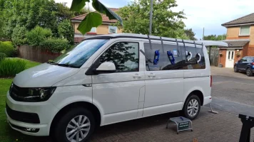

so working over the last 2 days thought I'd check in, using dodo matt Hex pretty easy application, cut & stick if any one has been dubious to do this don't be. just save yourself a spare day/2 if doing the cab also. I also purchased some 9mm ply from bnq and cut/measured all the battens for the floor.
day 2 I'd planned to put in thermoliner but as of yet its not been delivered I have cut out & applied 2 windows, I went with a 70mm holesaw for corners & reciprocating saw cutting for the inside leaning on the internal lip as a guide, was nerve racking at first but after the first cut it went pretty smooth, the usually masking tape & covers for external.paint and.dust sheet for front cab. I did the 2 today took around 5 hours, mainky.due to.doubke triple checking everything got 3 more tommorow & the dreaded leak check, I mistakenly ordered the fully pack from just kampers which didn't include the rear black.so looks like I'll need to order that after.20210626_201729.jpg
finished the final windows, found the trim from Just kamoers pretty long giving minimal space to apply primer, hopefully it's okay tommorow first 2 went fine after wet test just need to motorway test in the wet .... insulation arriving tommorow onto the next job ....
Windows are holding up, new tyres on and treated the original wheels to a satin finish, final decision is what colour to wrap the bottom half, waiting for delivery of everything inside so work on the outside will continue, new side bars & front splitter this week !! but its coming together now
