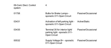

Accidentally damaged the interior light in the back and now have this error code 03435 Terminal 30 interior/parking light Open circuit
None of the interior or rear lights work.

Hello i got ibiza 2013 coupe and suddenly without doing anything headlights stay on even on 0 switch and rear or interior lights dont work also only dashboard , radio
