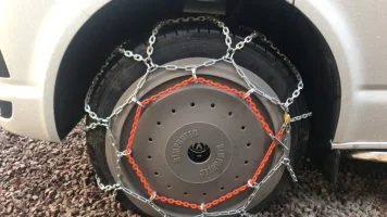

Those rimpprotect covers, could you use them for winter without snow chains?
