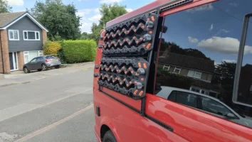

Back end of last year I added 'Sand Ladders' to enable self rescue from wet muddy camping fields, snow, or beach. I've haven't had to use them yet as we've been parked up since Nov. Since converting the van 4 yrs ago I have had 2 flexable bonded solar panels on the van. Each panel lived long enough to just make it out of warrany before failing. This time I have bought roof rails with 3 cross bars and fitted them to my roof. Because my van has a pop top, measuring up, drilling and fitting roof rails needs to be done with care and caution. I then mounted a rigid 200kw Renogy Shadowflux solar panel to the cross bars and run the cables in via the same access point as used for the flexable panel. Using roof rails has raised the total hight of the van a tad and has slightly changed the profile ref any 2mt hight barriers but alliws a good airfliw under the panel wgen parjed up on hot sunny days. I have not noticed any additional wind noise when motoring and as I have mounted the solar panel as far to the rear as possible It's not made the roof any heavier to lift. The solar panel is banging out the charge even on the dullest of days.
