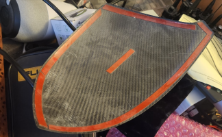

they are fitted with the UK sportline kit.
they just stick on over the top of the factory cover.

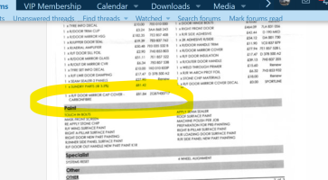

you should be able to order them from the VW CV parts dept. - you buy them individually
R/F door mirror cap cover - carbon fibre -
-- zgb7h00717

I'll drop a pic here to show where the stickers are.
