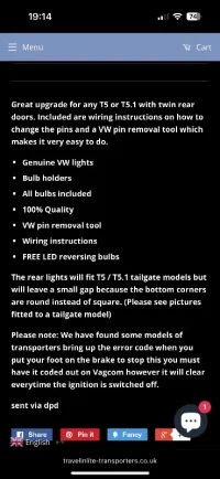

He re pinned them following this guide below, but the bulb warning came on.

This happened on my brothers T5.1, fine until you touch the brake pedal so I disable the bulb warning on the brake lights.
Travelinlite website does state this may happen
Okay mate brilliant
That shows 6.1 lights. These were t6
Edit: no, it doesn't
