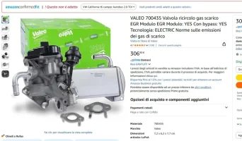

Amazon stock and sell (which counts for something IMO) the VALEO 700435 EGR Valve which is an OEM manufacturer and you have 30 days to return as unused if the issue isn't the EGR.
I personally wouldn't swap it as a preventative measure, only if broken, but others would so it's difficult to make that decision for you.
does it work for t6 150cv 2019? i'm asking because the amazon configurator says it is not ok for my car
The egr is very specific to each engine type and year... Or it will not fit.

for t6 diesel 150 cv 2019 :
I Know EGR 04L131512T is the old one and 04L131512cf is the latest version but i heard it's equal ...
correct me if i'm wrong ..
