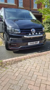

dear fish,
the info you require is as follows, however you will have to fabricate some bits yourself.
the lamp bar is from METEC and sold by spotbars.com, the lights are PIAA which you can't get
in this country anymore, so they came from across the pond from a motorcycle dealership found on ebay.,
they do come with the wiring and relays, I made a mount plate by my battery to put these
etc, the lamp bar takes 3 normal spot lamps, so I made a new plate out of mild steel to take the
set up I required,4 small high power spots, these are 55watt each but put out the equivalent of 85 watts each,
then had it powder coated black, the backs of the
PIAA lamps I painted in the same colour as my transporter pearl black.
you do have to remove the bumper and grill to locate the mount points for the spot bar supports.
if you decide to do it and need any xtra advice please message me.
seems like a lot of work, but once you make your mind up what you want, then go for it.
regards brookster69
