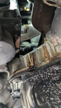

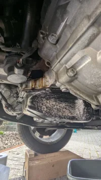

I am dealing with a severe coolant leak. After removing the undertray, I traced it to the water pump/thermostat module at the front of the block. (at least as far as I can see)
As shown in the attached video, it sprays a solid stream when revving at 90°C. It seems not to under this threshold.
