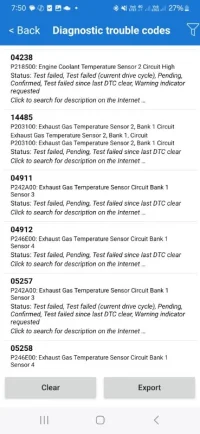

I started with an auxiliary coolant pump failure which I replaced, this was followed immediately by the DPF light coming on and then clearing after a forced regen, and a few day later I have circuit malfunctions on Exhaust Gas Temp sensors 2,3 and 4, and engine coolant temp sensor 2 high, fan is running full time
Codes are P218500, P203100, P242A00, P246E00
Attached is a snapshot taken from Carscanner Pro of the sensors with engine off, with engine running they flicker between normal running temp and 1000 deg. Ignore DPF in and out temps as they are a double up
