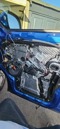

I have a T6.1 and I'm part way through installing the door card puddle lights. I followed the instructions which showed
+ve on red/white on the window motor which doesn't exist and is just white. This is the supply to the light via a relay.
-ve on black to the stud with the other -ve cables on the door
To drive the relay it requires a switched -ve which they've shown to brown on the door lock. Problem is the brown is a permanent -ve which leaves the lights on permanently. Other threads say connect to bk/bn on passenger and bk on drivers. The T6.1 doesn't have them and all the wiring to the door switch are white with 1 brown.
Has anyone any ideas?
Any help would be appreciated.
Dave
