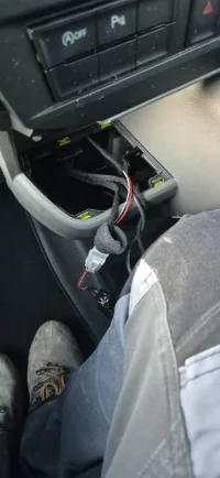

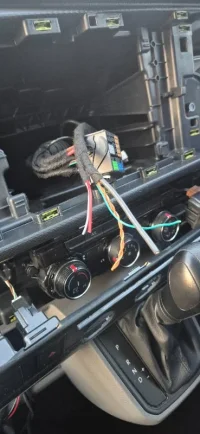

Making a start with the retrofit.
Just getting some of the new wiring required in place
It's my own loom. I had some left over ethernet cable from my previous caddy 5 so this is what I am using for future digital dash retrofit.
