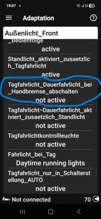

In VCDS it is a documented thing, in OBDeleven, as usual, it is a little difficult to find it, so here we go:
Control Units-> 09 Central Electrics-> Adaptation -> Außenlicht_front
(the menu is rather down towards the end of the list).
Then change the item circled in blue in the following picture:
