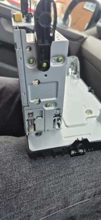

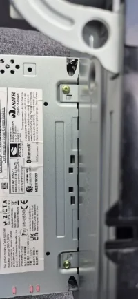

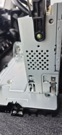

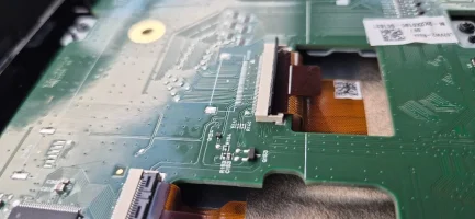

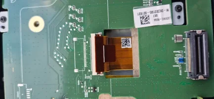

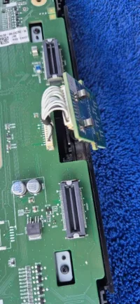

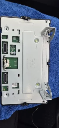

Had the dreaded ghost lines appear on my screen last week.
Fast forward £90 (new screen) and a couple of days later. Now all sorted.

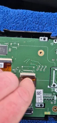

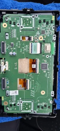

Not to difficult to do, just lots of small Phillip head screws to remove and 4 ribbon cable tabs. Very doable to do yourselves, just take lots of pics of all the part placements and be methodical as some screws were slightly different in length and size.
Keep me tied over now hopefully for the next few months until I decide what headunit I will upgrade to.
