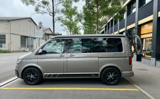

Distance from center of the whell to wheel arch are the following:
Front Left = 420 mm
Front Right = 420 mm
Rear Left = 386 mm
Rear Right = 400 mm
Almost 15 mm diference from left to the right.
I made a call to the dealer and they told me the difference was due to the Kitchen.. after reminding them that I have 2 slidings doors they told me to bring the Cali to a check.. After some testing, i was told that the 15 mm difference is in "tolerance". So they wouldn't do anything.
This is my first Cali, is this normal? A brand new car with 15 mm height difference in one wheel? My other car is a BMW G05 45e and the difference between the 4 wheels is less than 2 mm..
I made a call to Eibach (Alfatech in Switzerland) and the told me is a common issue and the gave me an universal plastic spacer to place on the rear left spring.
Then a took a look at the springs and figured out (as read on the forum) that they are compressed as the Cali was fully loaded (actually it was empty) ist this normal?.. will the spacer increase the compression?
I dont know what to do.. should I put the spacer on or get rid of the springs a buy a B14 Komfort/KW V2 set?
