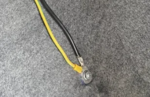

make sure all battery connections are fused.
make sure you have a good tight metal to metal bodywork ground . .
